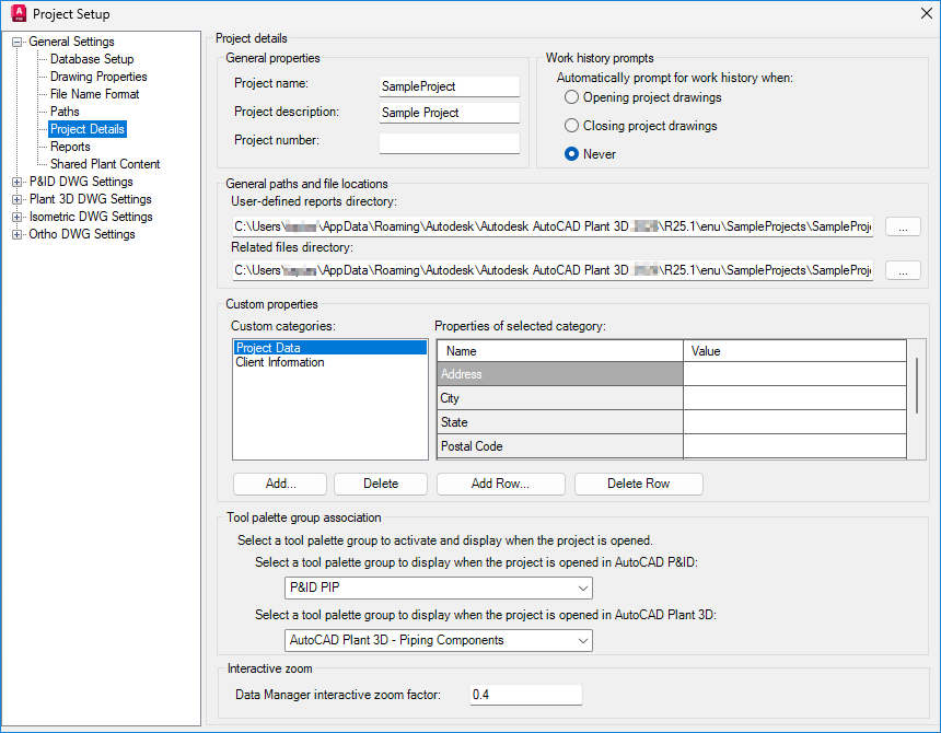

Project Setup
Configures project and drafting preferences, such as component symbology, tagging rules, annotation properties, layers, and colors.
 Ribbon: Click Home tab Project panel Project Manager Project Setup
 Shortcut menu: Project Manager Right-click a project icon Click Properties.
 Command entry:  projectsetup
The Project Setup dialog box displays a tree structure on the left side that is populated by items called tree nodes. When you select a tree node, node-specific content is displayed on the right side, where you make changes or additions to the project setup.
