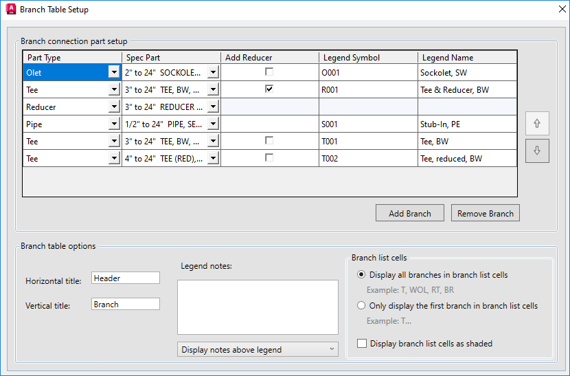

Branch Table Setup Dialog Box
Defines the fittings that are used in the branch table.
You can also set display options for the branch table.
Branch Connection Part Setup
Specifies branch fittings to use in the branch table and sets branch fitting priority.
Part Type
Specifies the fitting to use for the branch type. Specify pipe as the part type for a stub-in.
Spec Part
Specifies a part. If you set Use preferred part from pipe spec the part use priority in spec sheet is used.
Add Reducer
Adds a part to use for the branch. If selected, a second row is added for the branch connection. For example, you can add a reducer to a tee or reducing tee.
Up Arrow
Moves the branch fitting up the part setup table. The table order is for display purposes only, and does not change branch use preference.
Down Arrow
Moves the branch fitting down the part setup table.
Add Branch
Adds a row to the part setup table.
Remove Branch
Removes a row from the part setup table.
Branch Table Options
Sets display options for axis and a note.
Horizontal Title
Labels the horizontal axis of the branch table.
Vertical Title
Labels the vertical axis of the branch table.
Legend Notes
Adds a note to the branch table.
Branch List Cells
Sets display options for branch lists. A branch list specifies more than one branch type in a branch table cell. You can assign a branch list using the Select Branch List dialog box.
Display All Branches In Branch List Cells
Displays all branch types in a branch list cell.
Only Display The First Branch In Branch List Cells
Displays the branch type with the part use priority of 1 in a branch list cell.
Display Branch List Cells As Shaded
Displays branch list cells with a gray highlight.
