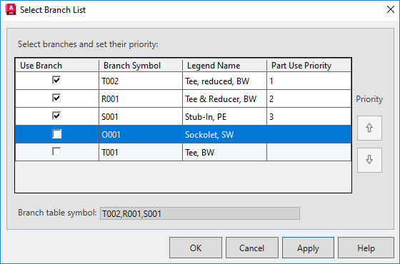

Select Branch List Dialog Box
Sets the preferred order of branch components used when routing and branching pipe in AutoCAD Plant 3D toolset.
List of Options
Use Branch
Specifies whether the branch type is included in the branch list.
Branch Symbol
Displays the Branch Symbol for the branch type. You can add and remove branch symbols in the Branch Table Setup dialog box.
Part Use Priority
Displays the priority for the branch type.
Priority Arrows
Sets the priority for the branch type.
