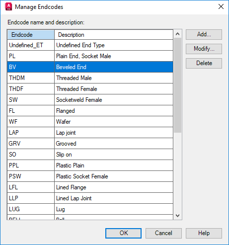

Manage Endcode Dialog Box
Adds or modifies joint endcodes.
Enter plantendcodes at the command line.
Use the Manage Endcode dialog box to add endcodes, change a description, or remove an endcode.
Note:
Endcodes are saved to the installation of AutoCAD Plant 3D toolset, they are not saved to the Project.
Endcode name and description
Displays the list of endcodes and descriptions.
Add
Adds a new endcode and description.
Modify
Changes an endcode description.
Delete
Removes the endcode.
