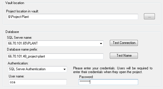

SQL Server Name
Specifies the server name. You can enter a name or select from the list of available servers. Click Test Connection to make sure you can make a connection.
Test Connection
Connects to SQL Server using the name and authentication provided.
Database name prefix
Specifies the database name prefix. This database name prefix is used to name a database for each project part. For example, if prefix is specified, prefix_PnId, prefix_Piping, prefix_Ortho, prefix_Iso, and prefix_Misc databases are created.
Test Name
Verifies that the database does not already exist on the server.
Authentication
Specifies whether to use Window or SQL Server authentication. If you select Windows authentication, no further information is needed. If you select SQL Server information, however, you must enter the appropriate user name and password. Also, users must enter credentials when opening a project.
Username/Password
Specifies your username and password for the SQL Server.
