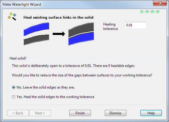

Heal existing surface links in the solid page
This page displays the number of gaps that are outside the healing tolerance. These gaps are highlighted in yellow on the model.
Healing tolerance — Enter a value to change the number of gaps outside the healing tolerance. The default value is the working tolerance.
Heal Solid?
No, Leave the solid edges as they are — Do not alter the surfaces to reduce the tolerance of the solid edges.
Yes, Heal the solid edges to the working tolerance — Attempt to reduce the gaps between the linked solid edges by surface boundary manipulation.
Finish — Perform the selected healing operation. If the healing process is unable to heal to the specified tolerance, a warning message is displayed.
When you click OK on the warning dialog, you are returned to the wizard so that you can change the Healing tolerance. Selecting Finish again displays a further warning message (if the healing process again failed to heal to the specified tolerance), or displays the Make Watertight Wizard Result page.
Dismiss — Close the Make Watertight Wizard, creating any required wireframe.
