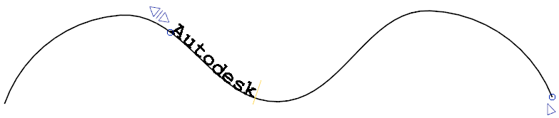

To create text on a curve:
  1. Ensure you have a curve displayed in the model. If required, create a curve.
  2. Click Annotation tab > Text panel > Along a Curve. The cursor changes to .
  3. Click a point along the curve to add text.
    An insertion point appears in the shape of a bar cursor.
  4. Type in the text.
Text can be added to any arc or curve. When you have created the text, edit the text on the curve as required.
