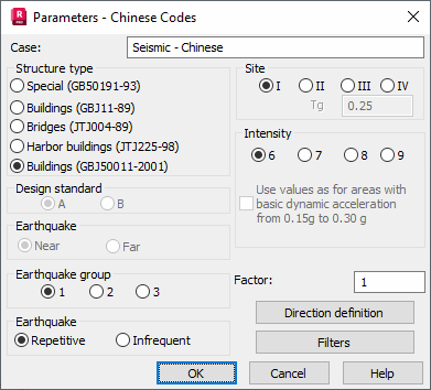

Parameters of a structure seismic analysis depend on a seismic code used during calculations of a structure influenced by seismic impact. Select seismic Chinese codes in the New Case Definition dialog or click Parameters in the Analysis Type dialog.
To complete the seismic analysis according to the rules given in a code, define the following parameters:
- Structure type (special, buildings, bridges, harbor buildings)
- Site
- Intensity
- Design standard
- Earthquake distance
- Earthquake group (it has effect on the T period)
- Earthquake frequency (it has effect on an alpha coefficient value)
In the lower part of the dialog, the Direction definition and Filters buttons are located.
The details concerning this structure analysis method can be found in the mentioned code.
