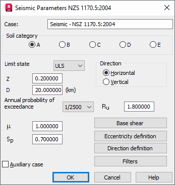

To perform the seismic analysis according to the rules given in the NSZ 1170.5:2004 code, define the following parameters:
- Soil category as one of classes from Clauses from 3.1.3.2 to 3.1.3.6
- Limit state (ULS, SLS)
- Direction (horizontal, vertical)
- Values of the coefficients: Z (hazard factor) and D (major fault distance) from Table 3.3, μ (structural ductility factor) determined in accordance with Clause 4.3.2, Sp (structural performance factor) determined by Clause 4.4
- Ru return period factor for the annual probability of exceedance as prescribed in Table 3.5
In the lower part of the dialog, the Direction definition and Filters buttons are located.
There is the additional button Base Shear; click it to open the Base shear dialog.
Click Eccentricity Definition to open the Definition of mass eccentricities dialog where you can specify how to account for the eccentricity of a mass in the seismic analysis.
