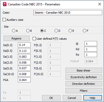

Code parameters
The code parameters for a seismic analysis according to NBC 2015 are defined as follows:
  • Site classifications for ground (A, B, C, D, E, F) conform with Table 4.1.8.4.-A
  • Site classifications for ground (A, B, C, D, E, F) conform with Table 4.1.8.4.-A.
  • Factors Sa(T) where Sa(T) - 5% damped spectral response acceleration, for periods T of 0.2 s, 0.5 s, 1.0 s, 2.0 s, 5.0 s and 10.0 s, depend on the selected province, and conform with Table C-3.
  • F(T) - site coefficient for spectral acceleration, for periods T of 0.2 s, 0.5 s, 1.0 s, 2.0 s, 5.0 s and 10.0 s, as defined in Sentence 4.1.8.4.(5).
    Manual definition of F(T) parameters is optional for site classes A-E after checking the box for 'User defined F(T) values' and obligatory for site class F.
  • Factor PGA - Peak Ground Acceleration, as defined in Sentence 4.1.8.4.(1).
  • Factor PGAref - reference PGA for determining F(T), F(PGA) and F(PGV), as defined in Sentence 4.1.8.4.(4).
  • Site coefficients Fa and Fv for a selected site class, according to subsection 4.1.8.4 (7) (and Table 4.1.8.4.-B and Table 4.1.8.4.-D).
    The displayed factor values depend on the selected province and site. You can change these values manually or you can click Region to change the province and site of reference.
  • Coefficients:
    • IE (earthquake importance factor) conforms with table 4.1.8.5.
    • Rd (ductility-related force modification factor) and Ro (overstrength-related force modification factor) factors conform with Table 4.1.8.9.
In this dialog, you can also access and modify the Direction definition, Filters, and Base Shear by clicking the dedicated buttons.
