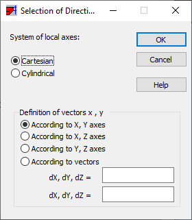

- Cartesian. The local element system will be adopted according to the orthogonal system defined globally by a user for all solids. The following coordinate options are available: according to X and Y axes, according to X and Z axes, according to Y and Z axes and according to the user defined vectors.

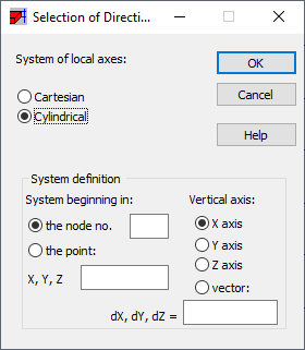

- Cylindrical. if this option is selected, then, the local element system will be adopted according to the cylindrical system defined globally by a user for all solids The following options are available: options that allow determining the system beginning (a point or node) and options permitting definition of the vertical axis (axes X, Y, Z or a vector). The components of results for solids xx, yy and zz in the cylindrical system of coordinates signify correspondingly the following directions: radial, circumferential and vertical (r, φ, z).

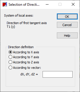

When defining a direction for cuts through solids (when the "Internal forces in the table" option is switched on in the Detailed tab) the Selection of Direction determines a direction of the first tangent axis T1 according to a selected vector or direction of the main coordinate system.

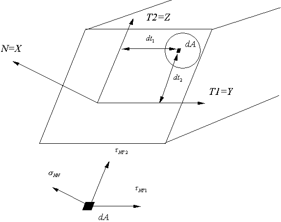

The coordinate system in the cross section is as follows.
- N axis - Normal to the cross section plane - x axis
- T1 first tangent axis to the cross section plane - y axis
- T2 second tangent axis to the cross section plane - z axis.
With the directions listed the following stresses are associated: σNN, τNT1 and τNT2.
