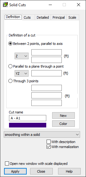

Solid Cuts is used for presenting maps on cuts through solids.
Results are shown on the cut surface.
The dialog consists of five tabs:
Maps on cuts are presented as averaged values between elements.
Smoothing (averaging of values).

The lower dialog contains the following additional options.
- With description. Presents descriptions for isolines or displays values at the element center; for isosurfaces it should be a single value for a given isosurface.
- With normalization. Automatic calculation of extreme values for the scale.
- Open new window with scale displayed. Opens a new window containing selected elements and objects. The window is split into a view and a scale legend.
