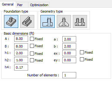

The General tab allows you to define the foundation type and its basic dimensions.

Foundation type
Select one of the following options:
  • Spread footing,
  • Continuous footing for a concrete wall.
Geometry Type
  • Rectangular spread footing or continuous footing,
  • Spread footing or continuous footing of a variable cross-section,
  • Rectangular spread footing or continuous footing for two columns.

Basic dimensions
Once the type and foundation geometry are selected, the list of dimensions for spread footing or continuous footing displays.
The dimension h4 is only a leveling layer of concrete which is not taken into account in calculations of the foundation (sliding, capacity, etc.).
Note: Foundation dimension editing depends on the selected foundation type and its geometry.
A Fixed option is located beside the dimension editing fields:
  • If deselected, foundation dimensions will be optimized to the applied load during calculations. These calculations may be performed prior to design in order to estimate the initial foundation dimensions for the applied load.
  • If selected, foundation dimensions are defined by the user and will not change during calculations and design.
