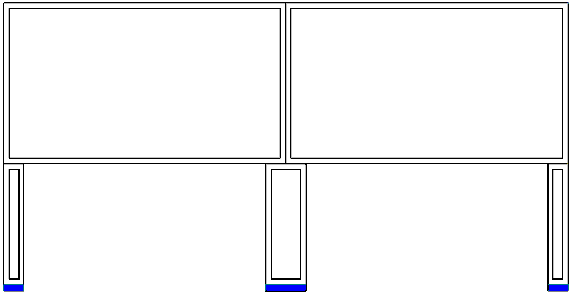

A model of a two-span deep-beam that is supported on columns is shown below. For the pinned support on columns, the thickness of columns is adopted as equal to the thickness of the deep-beam panel.
