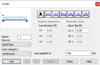

Click Load definition or select RC element > Loads to define the load to be applied to the designed deep beam.
  1. Define a load to be applied to a designed deep beam as follows.
  2. Enter the numbers of spans to which the load will be applied in the Spans field. Typing the letter A here results in selection of All deep beam spans.
  3. Select the load nature (dead, live, seismic and so on) from the Nature list.
  4. Select the type of load to be applied (continuous, concentrated or planar) from the Load category list.
  5. Define whether the load is to be applied to the lower or upper edge of the deep beam. It is also possible to specify an arbitrary level of load application measured from the lower edge of the deep beam.
  6. Define the value of the selected load type and click Add.
The left part of the Loads dialog changes based on the selected load type. It displays a scheme of the selected continuous or concentrated or planar load type. To the right are the load selection icons.
Below the Load Type icons is located the Relative Dimensions field. If this option is active, (the symbol √ appears), relative concentrated coordinates will be used in defining the load position (included in the <0,1> interval). If this option is inactive, the concentrated coordinates will be give in the length units chosen by the user.
If continuous load type is selected, the Dimension Chain option appears. If this option is active, (the symbol √ appears), a so called dimension chain will be used while defining a continuous load. This signifies that the continuous p2 load value will be applied at a concentrated with the coordinate (x1+x2), the p3 load value at a concentrated with the coordinate (x1+x2+x3) etc.If the option is inactive, the load p1 is applied at a concentrated with the coordinate x1, the load p2 at a concentrated with the coordinate x2 etc.
