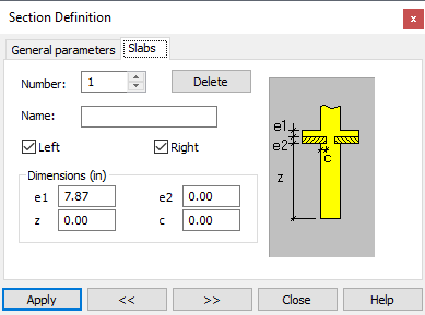

Cross-section (deep beam) - slab
Select the Slabs tab in the Section definition dialog to define parameters for a slab in the deep-beam cross-section.
The following slab parameters can be defined.
  • Number.
  • Name.
  • Position (to the left and/or right of the deep beam).
  • Dimensions characteristic as follows.
    • e1 - Slab thickness.
    • e2 - Thickness of the prefabricated strengthening inset..
    • z - Height at which the slab is located.
    • c - Support depth.
