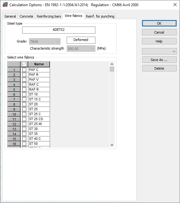

Once the Calculation options dialog box is activated for deep beams, walls or RC slabs and the Wire fabric tab is selected, the dialog box assumes the following shape.
The above dialog box allows the user to define the parameters of wire fabrics used for reinforcing deep beams, walls or RC slabs. One may select the database of wire fabrics and the parameters of reinforcing steel (steel type and grade, resistance).
Pressing the Edit database button results in opening an additional dialog box allowing one to present wire fabrics that may be used during calculations of reinforcement in deep beams, walls or RC slabs.
