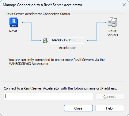

Use the following procedure to check the status of your connection to the accelerator that has been assigned for your location (as specified in your system's RSACCELERATOR2026 Release environment variable) and to specify a different accelerator when necessary. If you lose the network connection to a Revit Server accelerator or choose not to use one, you will be directly connected to the Revit Servers.
To check the status of or change a Revit Server accelerator
- Click Collaborate tab
Synchronize panel drop-down
Manage Connection to Revit Server Accelerator.
The dialog indicates which accelerator you are connected to, and its current status.
- To connect to a different accelerator, do the following:
- Enter its server name or IP address.
Note: You cannot switch to a different accelerator if multiple Revit sessions are open, a server-based central model is open, or the accelerator is not available.
- Click Connect.
When a valid connection is established, the successful connection status icon displays and the server name updates.
- Click Close.
