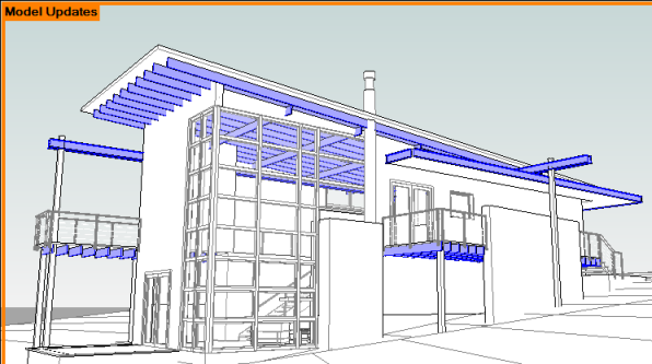

In the example shown here, the view displays model elements that need to be synchronized with the central model. Views with the worksharing display mode enabled display a colored border and the name of the applied display mode (Model Updates) as shown here. You can turn off or change the display mode at any time.
