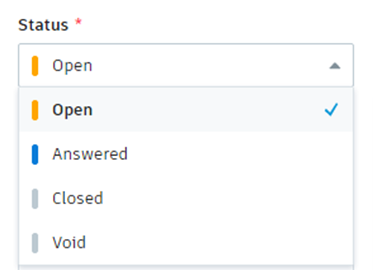

  2. Use the Status drop-down to change an issue's status. Only issue creators, owners and Autodesk Docs project administrators can set an issue to Closed.
