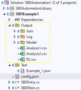

Output
Expand the folder named Output to reveal the output files generated by the automation run.
The automation output deliverables are covered in the Deliverables topic.
The output JSON contains key values from the analysis run for each command. Each CSV file relates to each analysis command in the input file. The comma-separated value CSV and Design Report PDF are optional output files.
The code file SBDOutput.cs in the SBDAutomationLibrary project defines all the output parameters that are currently available.
