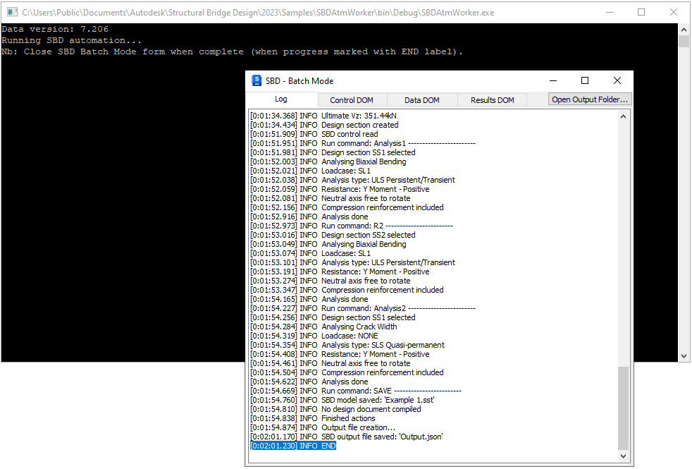

Automation Run
This will start the debugging process for the Example 1 automation application. You can then wait for the process to complete, which may involve executing the code, performing calculations, and generating any desired output.

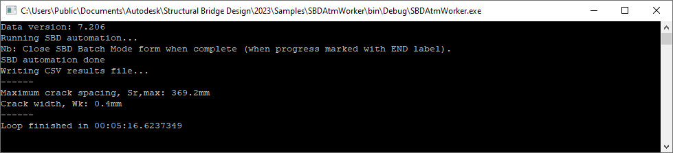

When INFO END is shown in the SBD - Batch Mode window, close the window.
To give an example of result value extraction, the values for maximum crack spacing and crack width are shown in the Console window.
For Visual Studio only, press any key in the Console window to finish and stop run.
