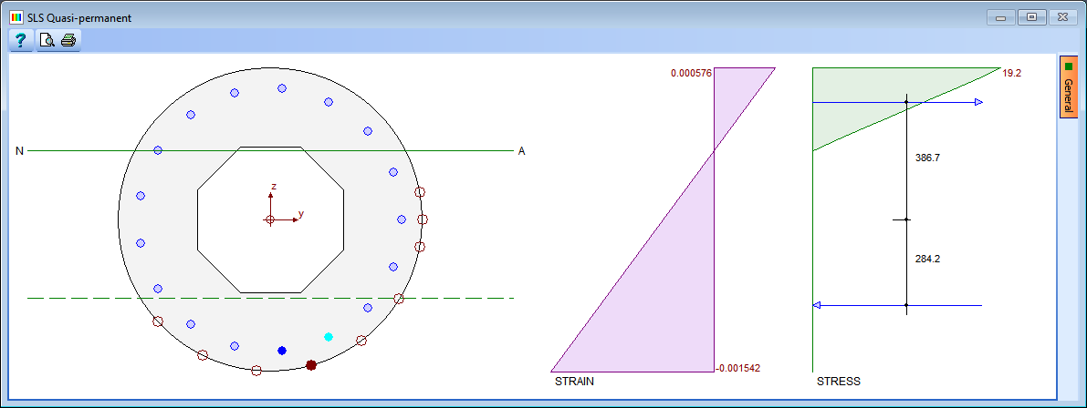

For example 1, we load an existing JSON file containing a circular reinforced concrete pile and run a biaxial bending analysis and crack width calculation. In the code, we modify the pile diameter and reinforcement while keeping the same cover, and re-run the calculations.
