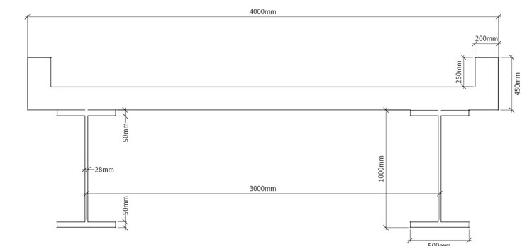

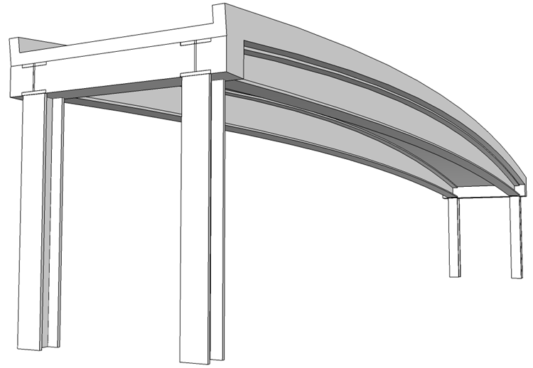

This access bridge is constructed with two steel plate girders supported on “H” piles acting compositely with a concrete slab. The top flange of the beam has an arched profile and it is deeper in the centre than at the ends.
The slab, diaphragm and upstand are created with grade C32/40 concrete and the girder with grade 355 structural steel.
The structure is modelled using a 3D shell finite element slab (curved in elevation) with a steel composite beam inserted as an FE web beam to explicitly model the web as finite elements and the flanges as beam elements. Upstands are added as edge beam members with the appropriate vertical offset and the diaphragm is represented with finite elements.

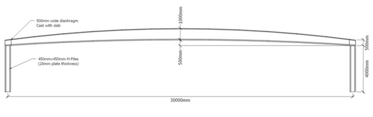

The beam, a 30m span, is assumed to be continuous at its ends as there will be some hogging at this location and this will affect the effective breadth of concrete flange. The adjacent spans (the piles) are assumed to be 4m long and fixed into rock at the remote end.
The girder has uniform thickness of web and flanges throughout (28mm & 50mm respectively) and the flanges are 500mm wide. The overall depth is set to 1000mm deep but with a sagging profile such that the overall depth at the ends is 500mm. This is done with 20 straight segments, as the curved profile is limited to hogging shapes. The profile points are not exactly on a circular curve but are close to it.
The slab in the beam representation is 2m wide and 0.2m thick, but is offset by 0.5m.
An edge upstand 200mm wide and 250mm deep is added above each edge of the slab and is assumed to be structural and cast with the slab.
Mid Span Section
| Profile of Top Of Beam | |
| 0.00 | 0.00 |
| 1.50 | 0.19 |
| 3.00 | 0.36 |
| 4.50 | 0.51 |
| 6.00 | 0.64 |
| 7.50 | 0.75 |
| 9.00 | 0.84 |
| 10.50 | 0.91 |
| 12.00 | 0.96 |
| 13.50 | 1.00 |
| 15.00 | 1.00 |
| 16.50 | 1.00 |
| 18.00 | 0.96 |
| 19.50 | 0.91 |
| 21.00 | 0.84 |
| 22.50 | 0.75 |
| 24.00 | 0.64 |
| 25.50 | 0.51 |
| 27.00 | 0.36 |
| 28.50 | 0.19 |
| 30.00 | 0.00 |
The carriageway on the bridge is a single lane of 3.8m, centred on the deck, with no footway or verges.
