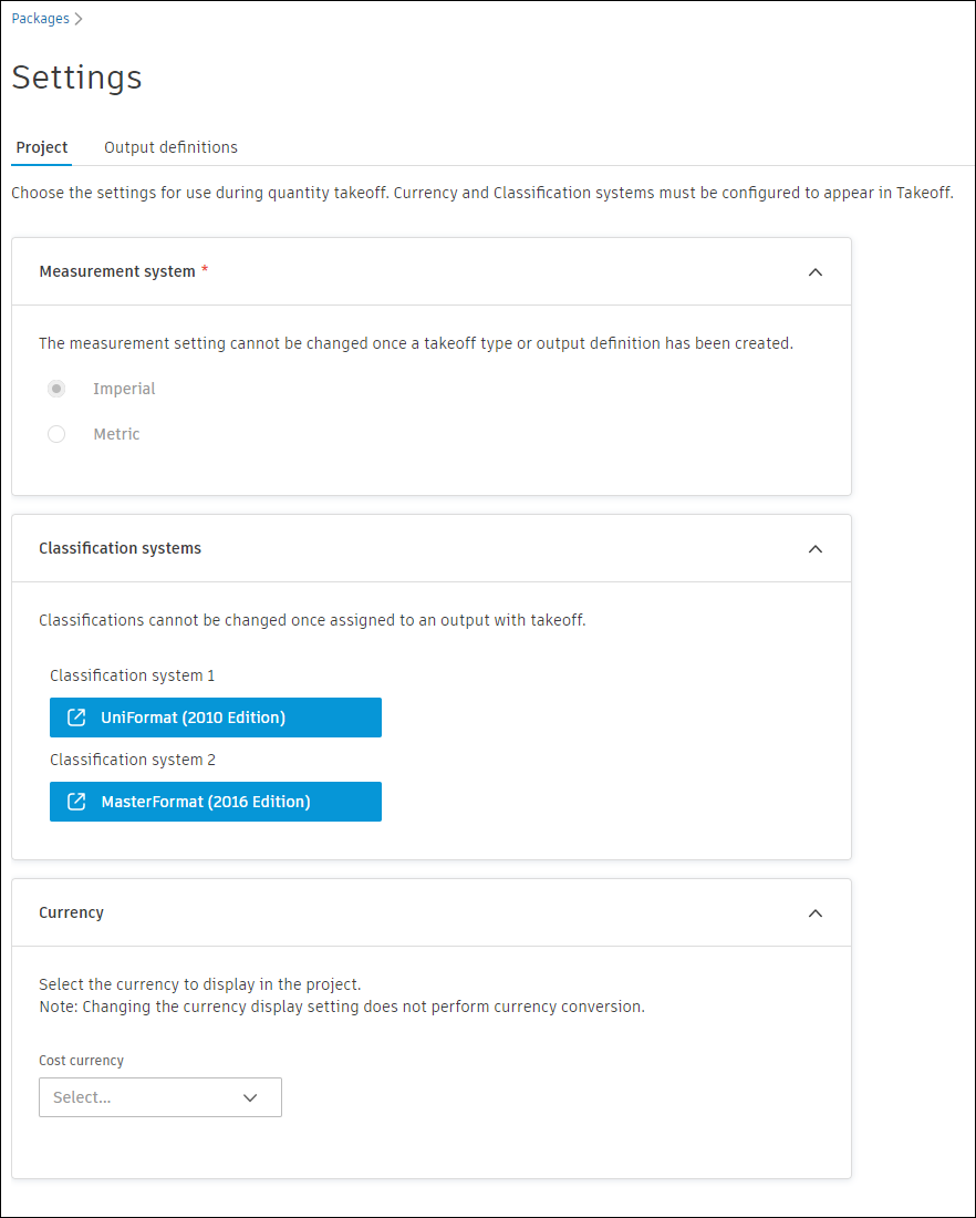

You can configure Takeoff settings in the Packages tool under Settings at the upper right of the page.
Under Project, you’ll find settings for Measurement, Classification systems, and Currency for your Takeoff project.

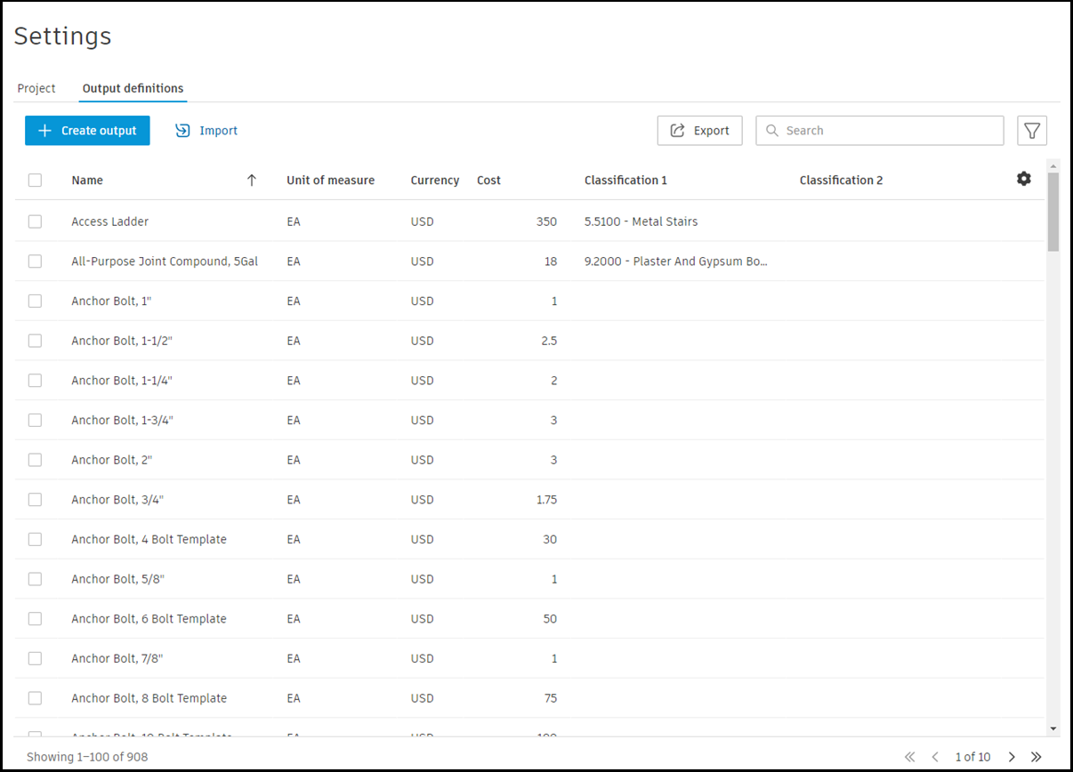

In the Output definitions tab, you can create, import, and view the takeoff output definitions available for your takeoff work.

  3. On the Settings page, the Project tab is open by default.

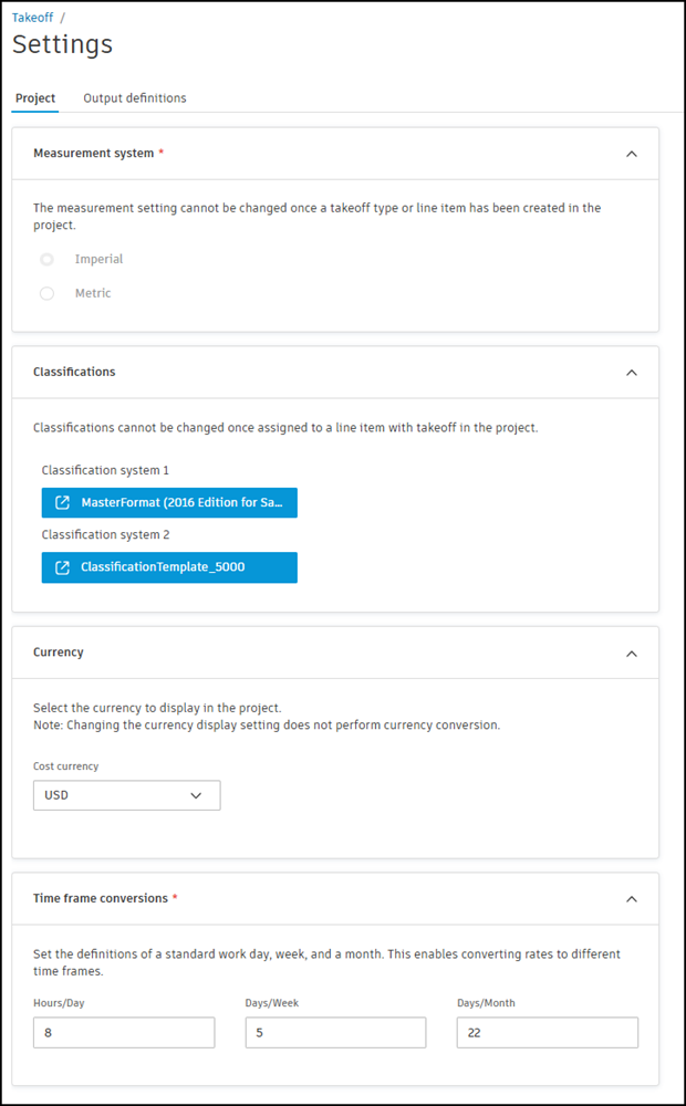

  3. Configure the following settings for your takeoff project:
    • Measurement system (required) - You must select a measurement system for a project before performing takeoff. Choose between Imperial or Metric systems.
      Important:
      Measurement system settings for a Takeoff project can’t be changed once a takeoff type or output definition has been created for the project.
    • Classification systems (optional) – You may upload one or two classification systems to use during takeoff under ‘Classification system 1’ and ‘Classification system 2.’ The classification system and its codes are used to describe and organize your takeoff items. You may be familiar with commonly used systems like MasterFormat® or UniFormat®.
      Important:
      Important: Classifications can’t be changed once a classification is assigned to an output with takeoff.
    • Currency (optional) – Use the Cost currency drop-down to select the currency to display when viewing Takeoff project costs.
Note: Changing the currency display setting does not perform currency conversion.

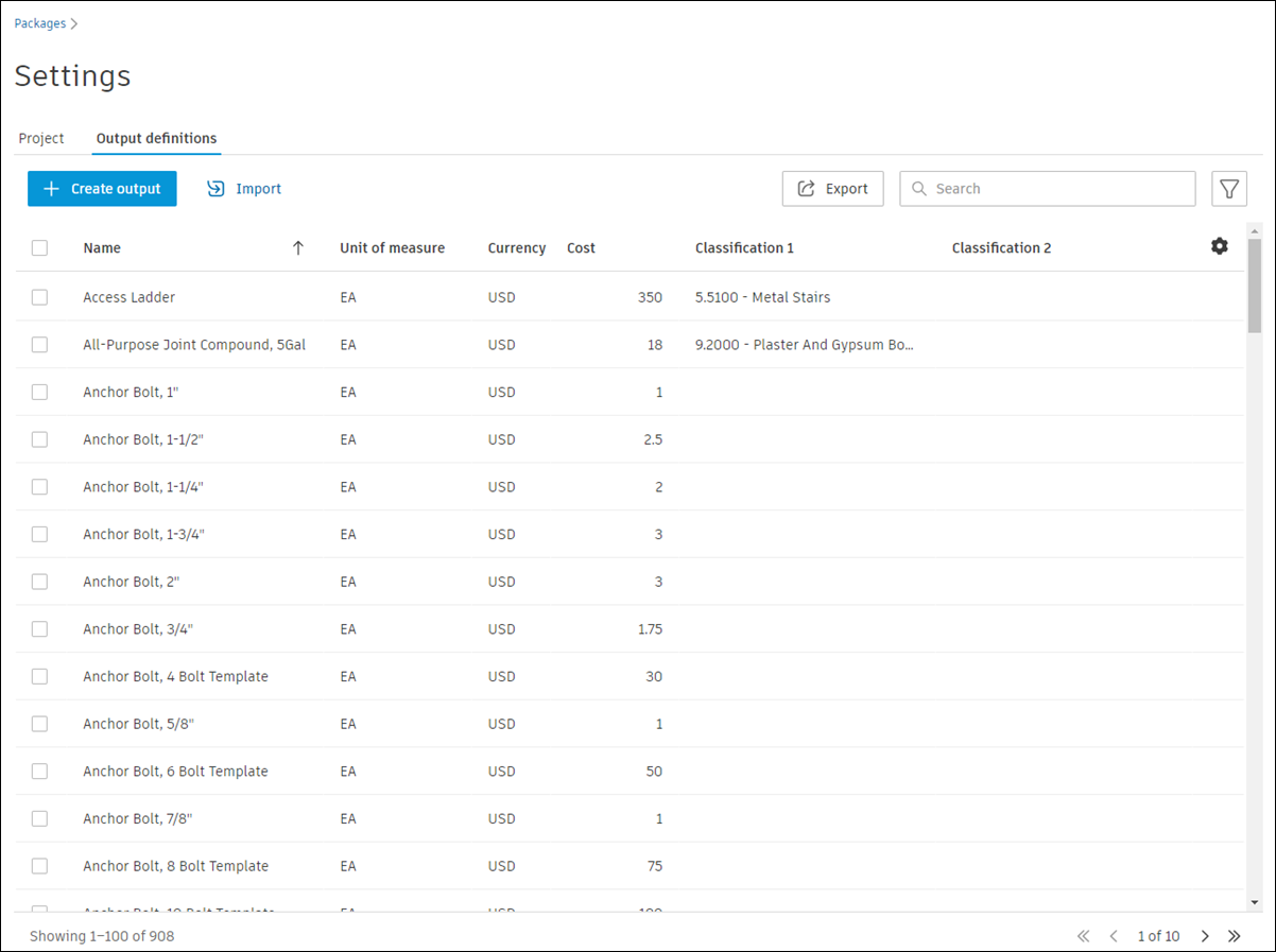

Create and Import Output Definitions in Settings
In the Output definitions tab under Settings in the Packages tool, you can create, edit, and view output definitions. You can also import multiple output definitions directly from a spreadsheet or from another project.
Use output definitions created in or imported to the Output definitions tab when creating takeoff types in the Takeoff viewer. Likewise, outputs for takeoff types created in the Takeoff Type panel can be saved to Output definitions.
Learn more about working with output definitions in Settings in Takeoff Output Definitions.
