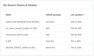

  • My Recent Sheets & Models with Takeoff - Get back to your most recent takeoff work. This card shows the sheets or models you’ve recently performed takeoff on.

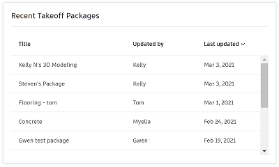

  • Recent Takeoff Packages – Discover work-in-progress on different takeoff packages in the project. This card serves as an entry point to other takeoff packages that others on your team may be working on.
