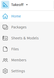

There are several tools listed in the left navigation of Preconstruction. Note that tools can vary depending on your subscription and other factors.
  • Home – Get a high-level overview of the latest Preconstruction-related activity in the project.
  • Estimate - Create project estimates using connected Autodesk Construction Cloud data, including Takeoff quantities. Note: Autodesk Estimate is only available with the Preconstruction Bundle subscription.
  • Takeoff – Create and view a list of takeoff packages for the project. Configure classifications, measurement systems and other settings for the project. Select a takeoff package to navigate to the viewer and its tools for performing takeoff.
  • Sheets & Models – See sheets and models that are available for use in Takeoff workflows.
  • Files – Store and manage all documentation associated with your construction project. PDF files can be published to Takeoff from the Files tool. Files stored in this tool are available to all Autodesk Construction Cloud products.
  • Specifications – Work with specifications and their data in Takeoff.
  • Reports – Use to create Preconstruction reports like the Takeoff Inventory report.
  • Members – Add team members to the project or to other products and tools on the project.
  • Settings – View and edit project settings for your Autodesk Construction Cloud project.
