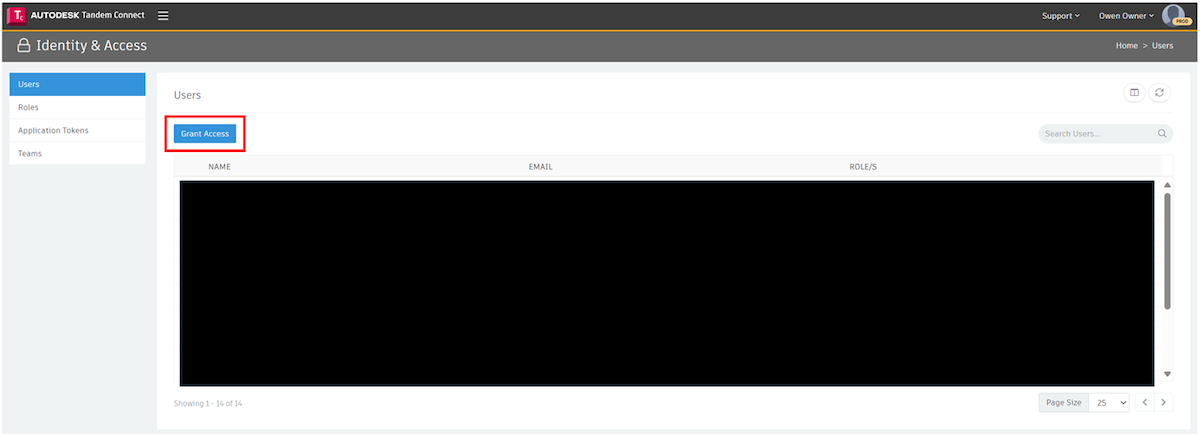

The Users feature allows users to create a user and set the access level permissions and roles for each user.
To create a user:

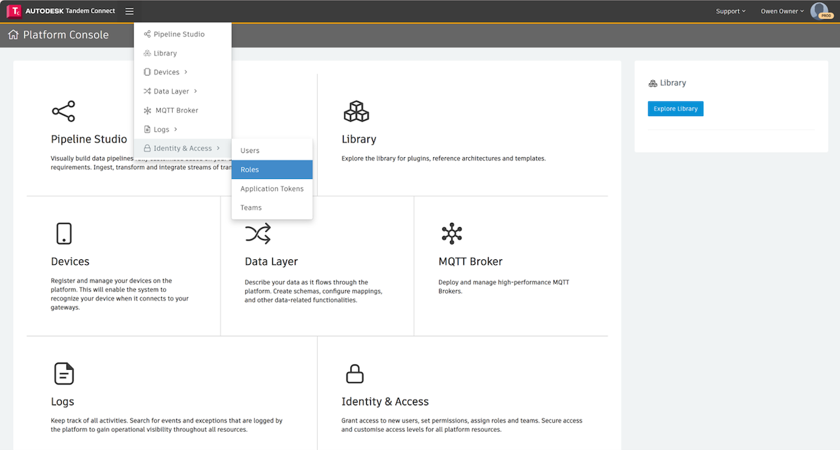

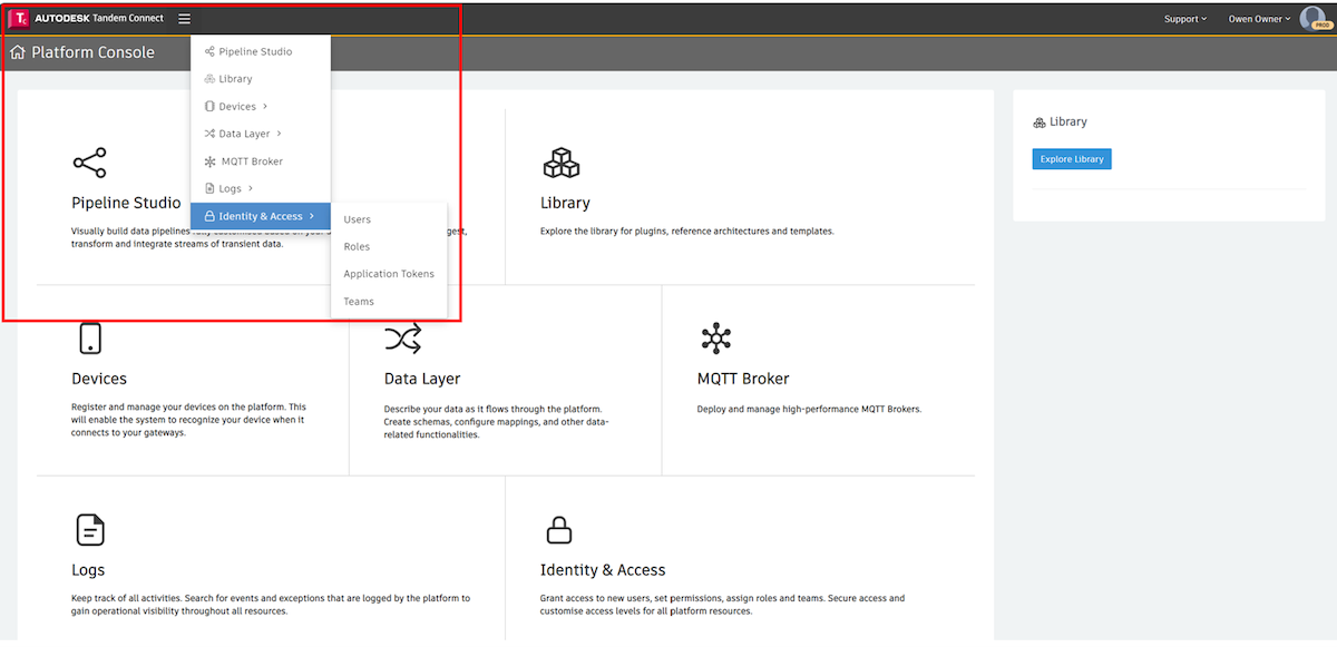

  1. Navigate to Identity & Access > Users from the navigation menu. The Users page opens.
alt text

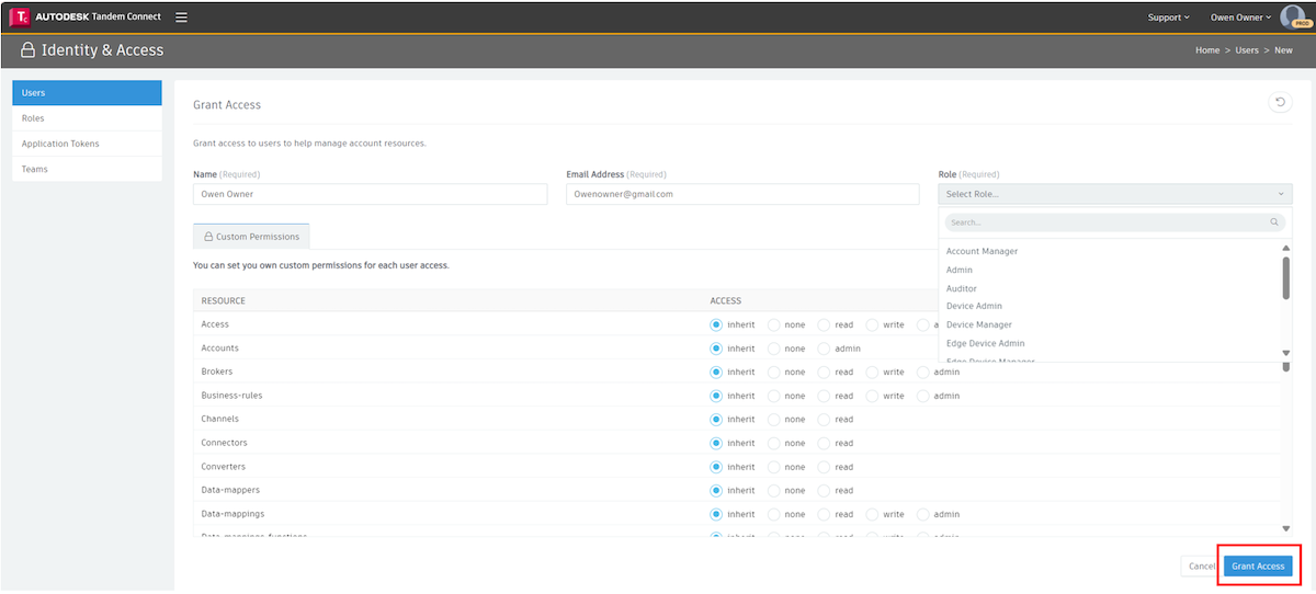

  1. Click Grant Access.
alt text
  1. Enter the name and email address of the user you want to add.
  2. Select the role you want to assign to the user from the Role drop-down menu. Note that you can select multiple roles.
  3. Click on Grant Access

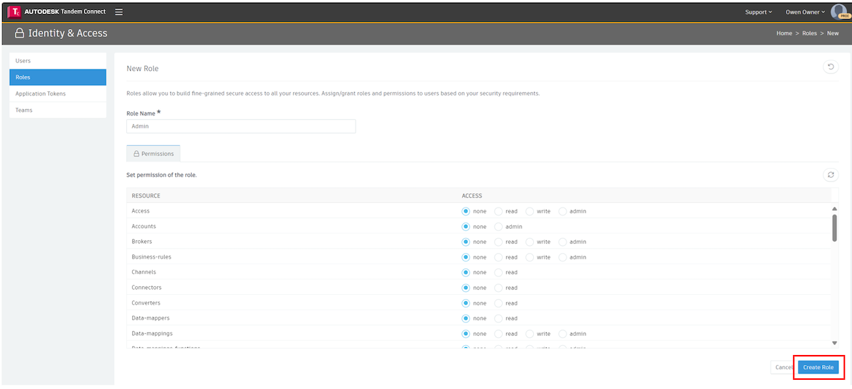

Roles
The Roles feature allows users to create a role and set the access level permission for each role.
To create a role, follow the procedures below.

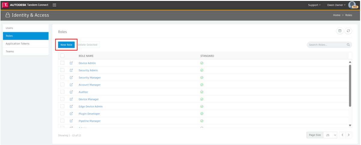

  1. Navigate to Identity & Access --> Roles from the navigation menu. The Roles page opens
alt text
  1. Click New Role. The New Role page opens. (Note: By default, there are a few predefined roles in the account)
alt text
  1. Enter a name for the role.
alt text
  1. In the Permissions table, select the access level you want to give to the role for each resource.
  2. Click Create Role. A confirmation message verifying that your role has been created will be displayed.

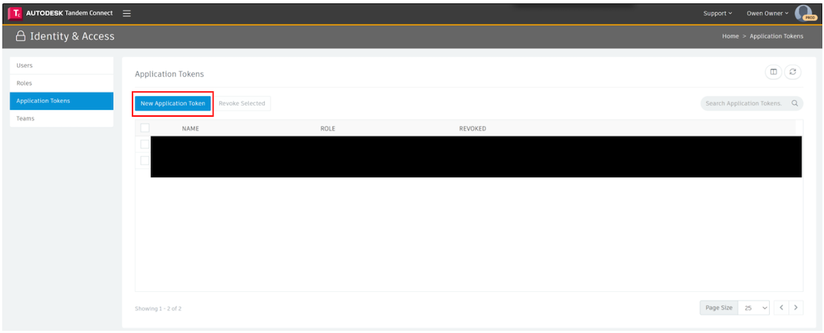

  1. Navigate to Identity & Access > Application Tokens from the navigation menu. The Application Tokens page opens.
alt text

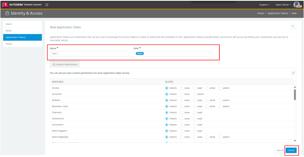

  1. Click New Application Token. The New Application Token page opens.

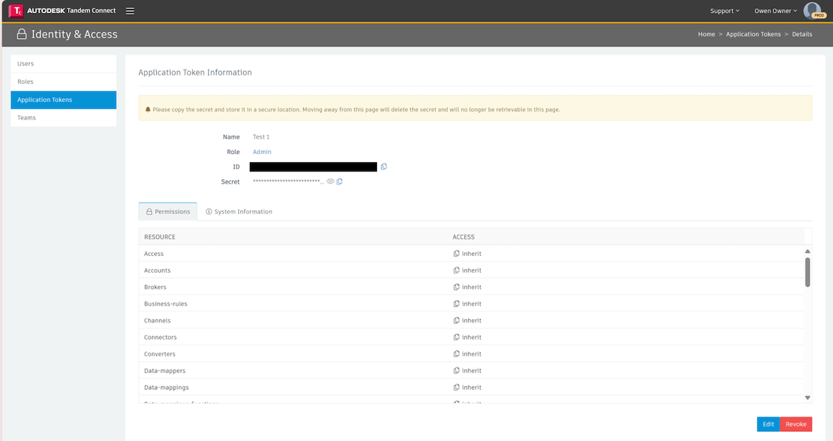

  2. Enter a name for the application token.
alt text
  1. Select a role you want to assign to the application token from the Role drop-down field.
alt text

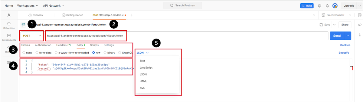

  1. Using the ID and Secret key of the application token created, obtain a bearer token, which will be used to access the Tandem Connect API. Refer to the screenshot below for a sample request using Postman:
alt text
Key Description
1 Make sure that POST method is selected
2 Enter the URL of the same environment where the application token is created then append /auth/token.
3 Go to the Body tab then select raw
4 Change Text to JSON.
  1. Click Send to complete your request. If the request is successful, the bearer token will be displayed as idToken in the Response section in Postman.
  2. Using the bearer token you obtained, you can now access the Tandem Connect API. Note that the bearer token expires within 30 minutes.
