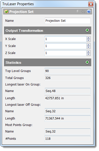

A projection set shows all groups and subgroups to include in the projection. Managing projection settings can help to prevent flicker and improve quality.
To access the settings, double-click on a projection set in the tree:
The settings window appears:
Enter your settings and click Apply. Refer to the table below for property details.
Name A unique name that helps you easily identify the projection set.
X Scale Horizontal scale
Y Scale Vertical scale
Z Scale Depth scale
Top Level Groups The number of first-level groups in the projection set
Total Groups The total number of groups (first-level and sub-groups) included in the projection set
Longest Laser On Group Name The group containing the longest distance for the laser to travel before repeating.
Length If you are experiencing flicker you could optimize the group or break the group into multiple groups to shorten the distance.
Longest Laser Off Group Name The group containing the longest laser off distance.
Length Laser off means that the laser comes to the end point and turns off to get back to the start point. If you are encountering issues, adjusting the start and end points could improve the laser quality.
Most Points Group Name The group containing the most points.
# Points The laser must start and stop at each point it encounters in its path. If, for example, this value is 100, the laser must stop and start 100 times in less than a second. If this value is above 100, there is a good chance you'll experience flicker. Lowering this value might improve laser projection quality.
