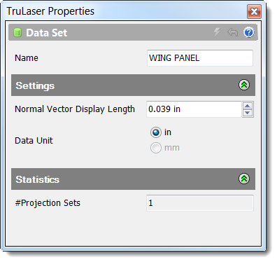

The data set appears at the top of the tree and stores all the laser data for the project.
To access the settings, double-click on the data set in the tree:
Enter your settings and click Apply. Refer to the table below for property details.
Name The name for this laser data set. This value is also used as the file name for laser projection files created from this data set.
Normal Vector Display Length The length of the line segment that displays in TruLaser to represent the normal vector direction from each laser point. The display length set up in Options automatically appears. To change the length for this instance, enter the new value in the Properties browser. To change the default value, click Options in the ribbon and select General.
This value is not passed to a laser projection file; it only serves as a visual aid to show the user where the normal is currently pointing.
Data Unit The unit of measure (either inches or millimeters) for the laser projection projected. This is a display-only field that cannot change.
# Projection Sets The number of data sets (including cloned sets) in your current assembly.
