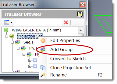

Adding a Group
To add a group right-click on either the projection setting node or group node if you want to add a sub-group.
Select Add Group to add a group node.
Now that the group is added, you can enter the group properties.

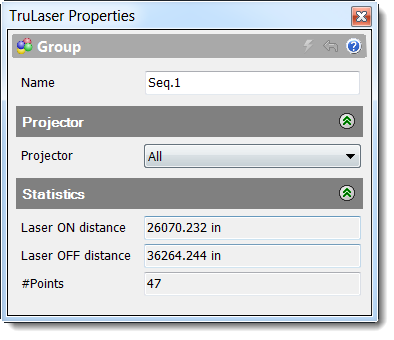

Adding Group Properties
To define the properties for the group, either double-click on the group name or right-click on the name and select Edit Properties.
Enter your settings and click Apply. Refer to the table below for property details.
Name A unique name that helps you easily identify this group.
Projector Select the name of the projector to associate this group with. If this is not set, the projector will be chosen automatically by the projection controller at projection time.
Note: This feature is not supported by some brands.
Laser ON Distance The total distance that the laser projector travels while displaying all the data in the selected group.
Laser OFF Distance the total distance that the laser projector travels while moving to the correct locations to start laser projection. In other words, the wasted distance that the laser projector must travel to correctly project the data in the selected group.
#Points The total number of individual points in the selected group.
