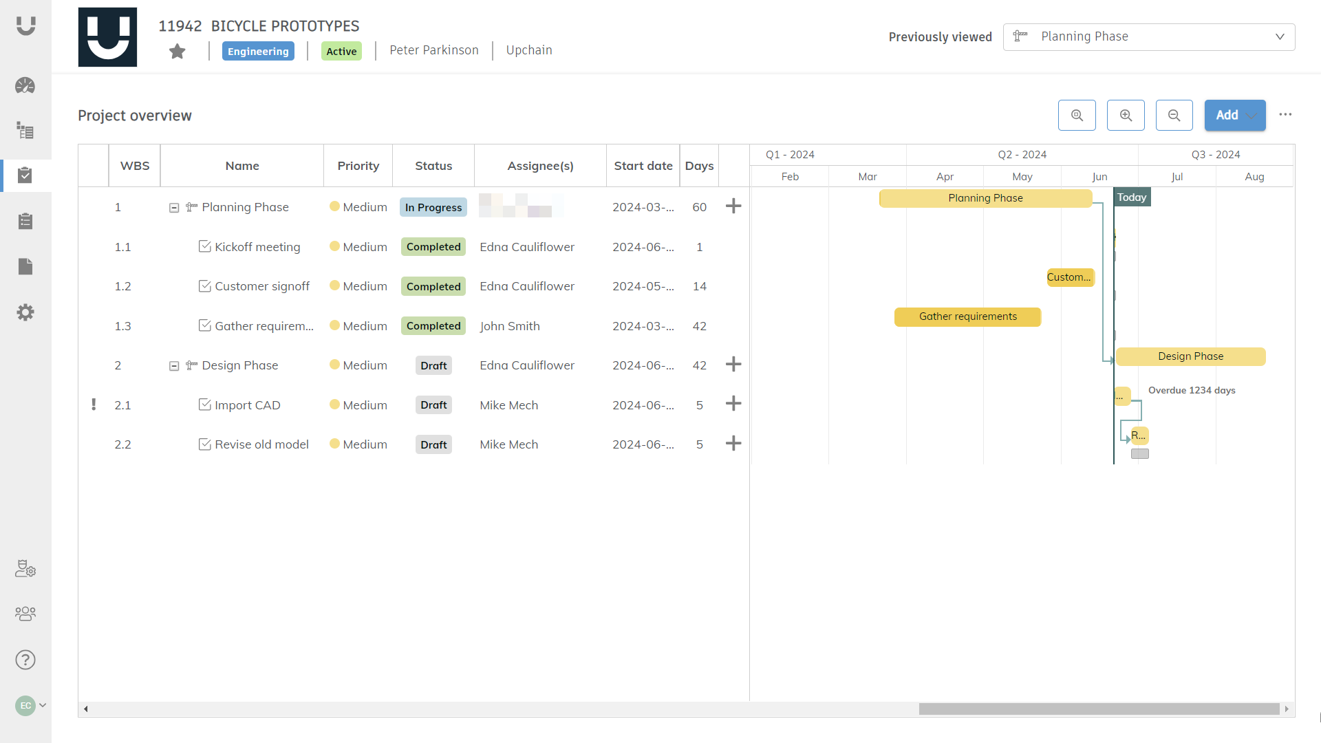

The project management interface displays a project’s activities in list view. You will see an activity's name, priority, status, assignee, start date, and duration.
project management ui
Note: This image shows Upchain's new theme. Click the chevron next to your profile icon in the main dashboard to open the user menu and select Switch theme.
  • Activities are listed on the left side of the page and the Gantt chart is shown on the right side.
  • Click the magnifying buttons to zoom in, zoom out, and zoom-to-fit the Gantt chart.
  • Click Add in the top-right corner to add a new project management activity to the top level of the list of activities.
  • To add a child task to an existing activity, click Add (sub_activities_add_icon.png) to the right of the activity. Only the creator of the activity may add additional sub-activities.
  • Click more actions (global_actions_icon.png) to access more options, detailed in Work with the Gantt chart.

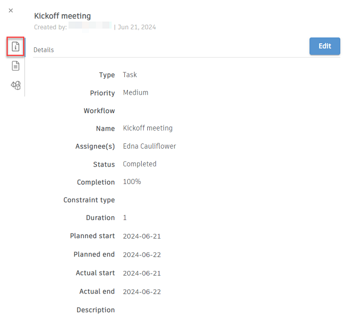

Click an activity in list view to open its detail view. The detail view contains additional information about the activity, as well as the workflow buttons to enable the activity assignee to progress the activity's workflow.
Details tab
The details tab is shown by default when you open an activity's detail view. This tab contains the workflow buttons as well as all of a selected activity's details, including its type, priority, workflow, name, assignees, their out-of-office status (if applicable), start date, constrain type, duration, planned start/end and actual start/end, status, completion percentage, and description.

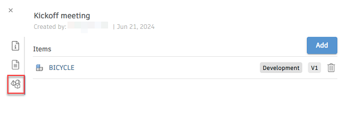

Items tab
The items tab shows a list of all items that have been associated with the selected activity. This is helpful for quick access to BOM items related to the activity. For example, the activity might be for gathering additional requirements for the item associated with the activity. The information shown includes item type, name, workflow status, and version number.
