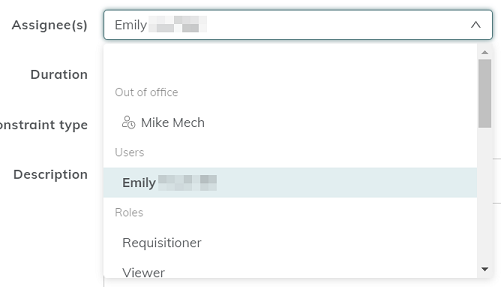

When assigning a project management activity
When creating or updating a project activity, any project team member that has an OOO set for their account are listed at the top of the Assignee(s) drop-down list to clearly indicate who may not be available to complete the activity.

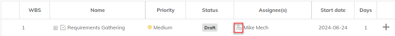

In the list of project activities
The list of project activities shows the OOO icon (mceclip1.png) for activities assigned to team members whose OOO timeframe falls on or within the assignment's scheduled duration.
