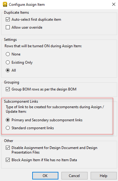

Leverage the Flexible Sub-component Links Feature to Suit Your Design Process
Control the link type for sub-components by configuring whether Primary and Secondary or Standard component links are used during an Assign Item or Update Item event.
