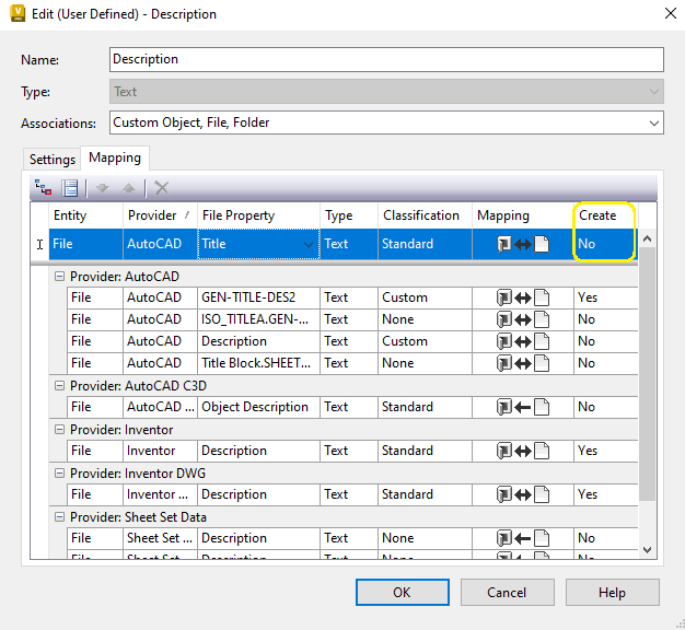

Use an AutoCAD Mechanical Property Mapping Key
AutoCAD Mechanical files can be challenging when setting up the property mappings because of the number of names you must keep in mind: the internal name, the default display name, and any overrides you may have done on your own. For this reason, Autodesk recommends using a spreadsheet, such as the one highlighted in this blog, to keep track of your property values.
Use Bi-Directional Mappings
Bi-directional mapping means that you can automatically update BOM properties in AutoCAD Mechanical from your vault, and vice versa.
Do Not Enable the Create Setting When Configuring Mapping
Autodesk recommends that the Create setting on the Mapping tab be disabled for properties you are mapping to AutoCAD Block attribute properties.
This setting influences file properties only and not block attribute properties and may cause issues with synchronization.
Note: See Map Properties for more information.
