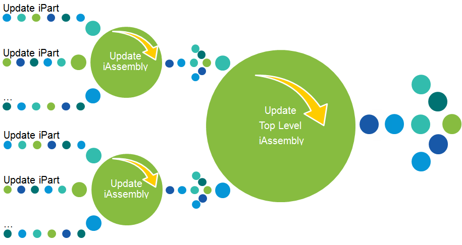

Update Factory
Note: When updating, be sure to follow the tips in Creating Factory Members.
