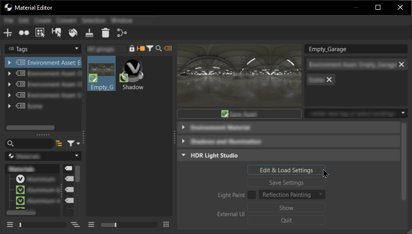

How to Connect Area Lights to HDRLS
Area Lights from HDR Light Studio Video Captions: In VRED 2020.1, we have implemented the support of area lights from HDR Light Studio. When creating a light with HDR Light Studio and setting it as an area light, VRED will automatically creates an area light node under the environment group, using the same textures as in HDR Light Studio. All values will be taken over from HDR Light Studio, instantly, so you can directly see the changes in the VRED scene, like changing the brightness or moving the light or changing its size. This gives the user more flexibility and a seamless workflow for creating new environments, using HDR Light Studio and VRED.
Connect your VRED environment to HDRLS (HDR Light Studio). For information on rendering, see the note in Rectangular Lights.
The Tungsten version or higher of HDR Light Studio must be installed to do this. It can be downloaded from here.
In the Material Editor, select an environment material, then in the HDR Light Studio attributes section, click Edit & Load Settings.
Enable the Area Light option to create a light node in HDR Light Studio, that will promote this light to an area light. VRED automatically creates a rectangular area light, then receives a texture, transformation, enabled state, and primary visibility for the area light.
In the Scenegraph, the light becomes part of the Environment node of the environment material connected to HDRLS. All area lights belonging to this environment are added to a group (both in Scenegraph and Light Editor).
When switching the HDRLS Area Light option on/off, the light node is re-created in VRED.
A Smart Dolly of 1000.0 (in HDR Light Studio) positions the area light 1000 units (default: mm in VRED) from the world center or last light paint point. If your object is bigger than 1000 mm (1 m), the light might be initially inside the object. Increase Smart Dolly or use light paint to move it out.
Try setting the HDR Light Studio Smart Dolly Scalar preferences to 10. This sets the default distance of an area light of the world center or light paint position to 10.000 units in VRED. Use the Smart Dolly slider to bring the light closer and inside the dome. It helps to make the dome geometry larger, so the area light fits inside the dome.
