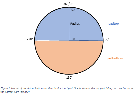

Setting Virtual Buttons on Touchpads
Some controllers, like the ones of the HTC Vive, have touchpads that can be split into different areas to simulate more buttons. The class vrdVRDevice provides the method addVirtualButton, which takes two arguments, one object of type vrdVirtualTouchpadButton and a string for the corresponding non-virtual button it belongs to.
padTop = vrdVirtualTouchpadButton("padtop", 0.0, 1.0, 270.0, 90.0)
padBottom = vrdVirtualTouchpadButton("padbottom", 0.0, 1.0, 90.0, 270.0)
This example starts with creating two vrdVirtualTouchpadButton objects. The first argument of the constructor takes a name for the new button, the second and third argument describe the radius where the button is located, in this case it uses the full radius of the touchpad. The fourth and fifth argument describe the angle on the touchpad where the button is located. In these two cases, the first button will cover the top half and the second, the bottom half, of the touchpad. Figure 2 illustrates the layout of the two buttons. Note that in case of overlapping buttons, only one of the buttons will send a signal. It is recommended to not create overlapping buttons.
Figure 2: Layout of the virual bottons on the circular touchpade. One botton on the top part (blue) and one botton on the bottom part (orange).
After the instantiation of the virtual buttons, they are added to the controller.
controller.addVirtualButton(self.padTop, "Touchpad")
controller.addVirtualButton(self.padBottom, "Touchpad")
The method vrdVRDevice.addVirtualButton takes two arguments, the first is the vrdVirtualTouchpadButton object and the second is the name of the actual button on which the virtual button is placed. In VRED, this currently works only for the round touchpad of the HTC Vive controller.
The newly added virtual buttons can now be used like regular buttons, when creating device actions.
myAction = myInteraction.createControllerAction("left-padtop-pressed")
