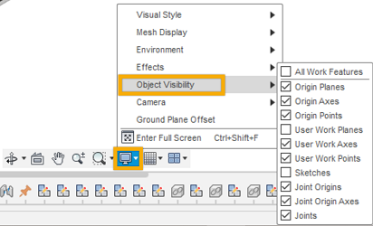

  • If you hide any object types in the Navigation bar > Object Visibility settings, they take precedence over any visibility adjustments or overrides applied in the Browser.
