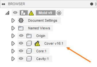

part example
In the previous example, the component Cover only triggers an update to the design Mold when a new milestone is created for the Cover.

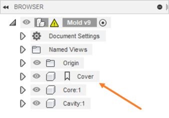

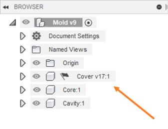

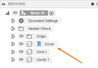

Once out of date components are updated, components with milestones have a flag icon on them, indicating the design is using a milestone version.
part example2
In the previous example, the Cover component is using the latest Milestone version.
The milestone versions also have priority when inserting them into a design. They are inserted even though there are more recent versions of the design.

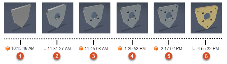

When you modify and save a design, Fusion automatically records this as a time-stamped change in the History panel. When you are ready to mark a design state as a significant iteration, you create a version.
For example, after several saves while creating a design, you decide you'veadded all the features you need. You then create a version to indicate that this is the first iteration of the part. Then you can continue to make changes for an alternative design, then create a second version to represent this alternative design.
changes and versions
  1. Initial design save design save
  2. First version creation latest version
  3. Design save design save
  4. Design save design save
  5. Design save design save
  6. New version creation latest version
Using versions on components and subcomponents enables multiple people to work on the same project. One person can work on a subcomponent and make changes, but the parent component still references the most recent version. When a person versions the subcomponent, the upper component will reference that new version. In other words, when you insert a part file with a version into a design, the design will always reference the most recent version of the part. Regular saves and changes are not automatically reflected in the parent design. Only versions are.
