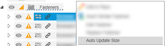

Auto Update Size
After you get notified that a fastener no longer fits, you can right-click the fastener in the Browser and select Auto Update Size. This will automatically update the size of the selected fastener.

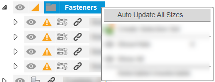

Auto Update All Sizes
You can also right-click the Fasteners folder in the Browser and select Auto Update All Sizes to automatically update all the fasteners that no longer fit.
