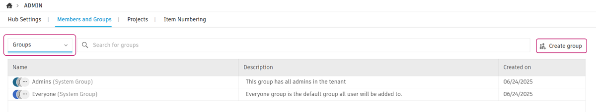

    1. Open the Members and Groups tab.
    2. From the drop-down list in the top left, select Groups.
    3. Click Create group.

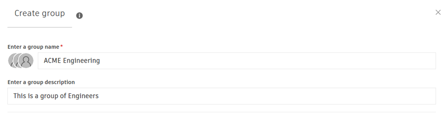

    4. Enter group name: ACME Engineering.
    5. Enter a group description: This is a group of engineers.
      create group

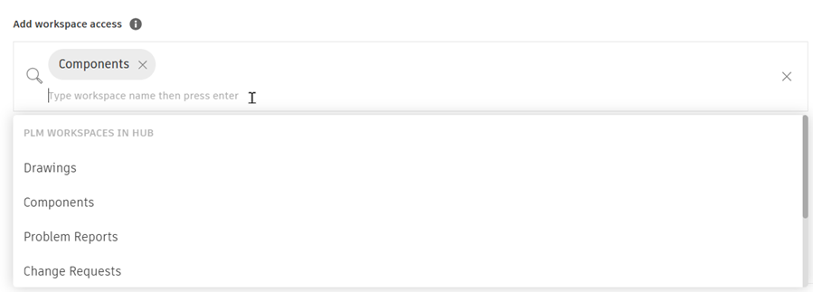

    1. In the Add workspace access section, click to select all change managementworkspaces, then press Enter.
      add workspaces

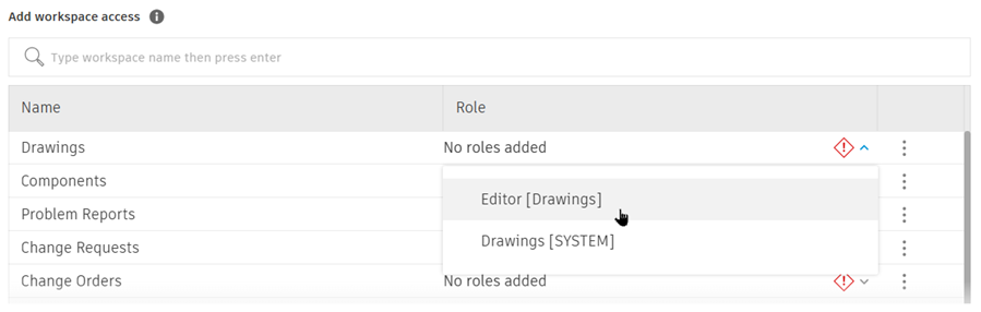

    2. In the table, click the Role drop-down beside each workspace to assign these PLM roles - Editor [Components], Editor [Drawings], Editor [Change Requests], Editor [Change Orders], Editor [Problem Reports], Editor [Change Tasks], Viewer [Change Approval Templates].
      add roles

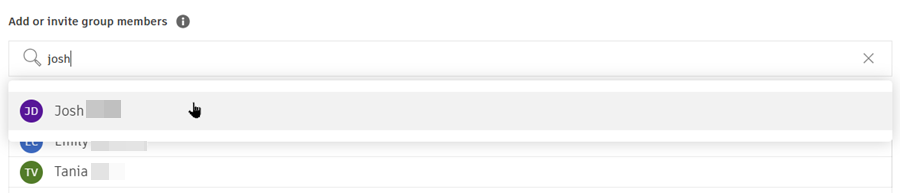

    1. In the Add or invite group members section, click to selecting existing team members to the group. Enter email addresses of team members you want to invite to the hub. Then press Enter.
      add users
