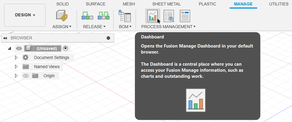

    3. Click the Manage tab.
    4. Place your pointer over each tool in the Manage tab and read the tooltips.
      manage toolbar

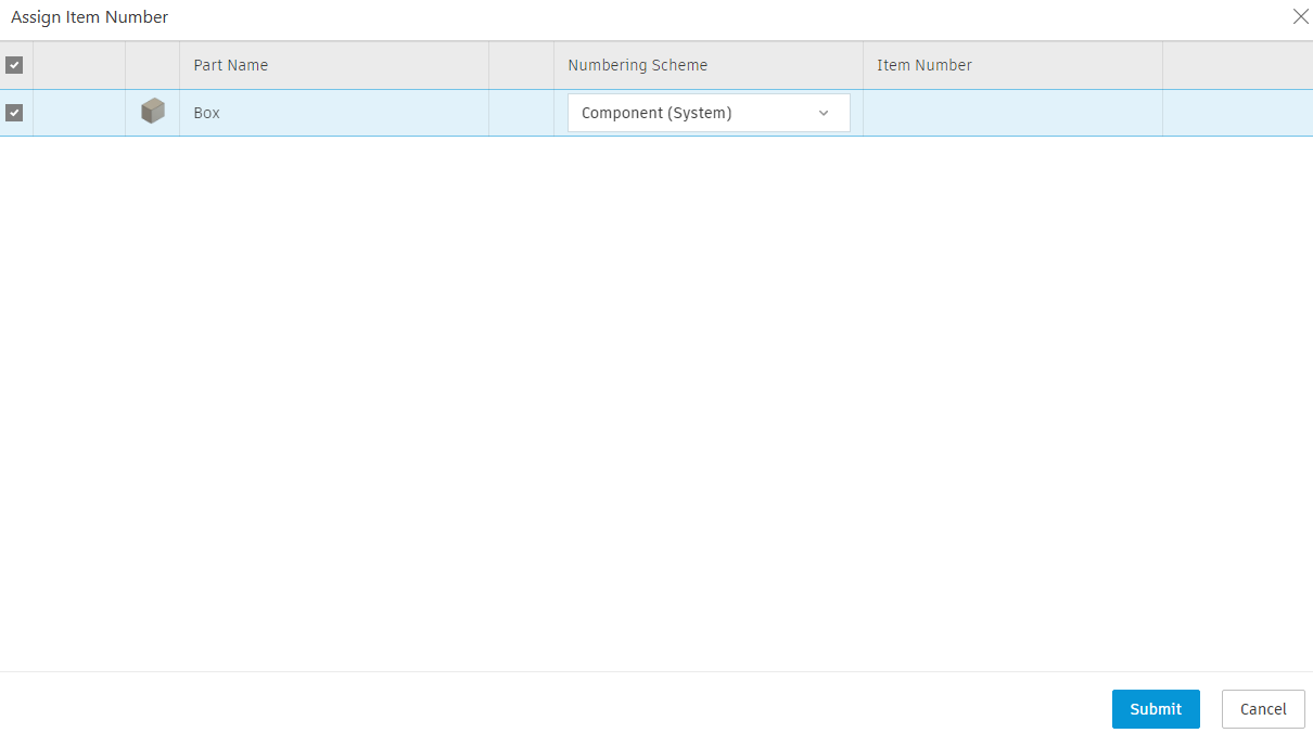

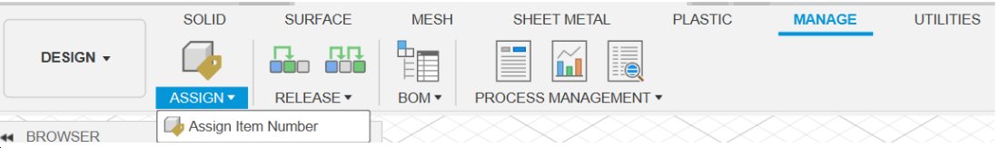

    3. From the Manage tab, click Assign > Assign Item Number.
      assign item
      Note: For now, you'll use the default item numbering scheme. In another tutorial, you'll explore assigning item numbers in more detail.
      item number

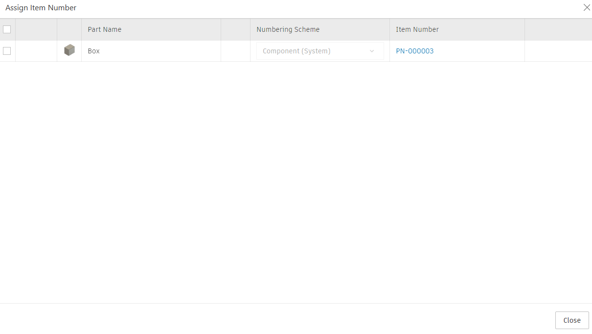

    4. Select the item, then click Submit. Wait for the item number to be assigned, then close the window.
      number assigned

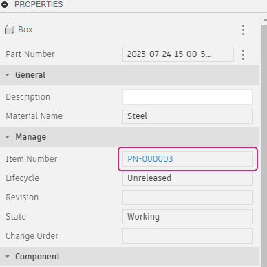

    5. Open the Properties for the component.
    6. From the Manage section, click the Item Number.
      item properties

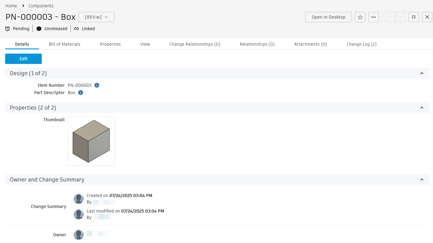

      The Fusion Manage Extension site opens to the item in the Components workspace.
      item workspace

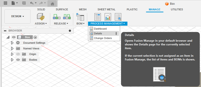

    2. From the Manage tab, click Details in the Process Management section.
      item details
      item workspace
