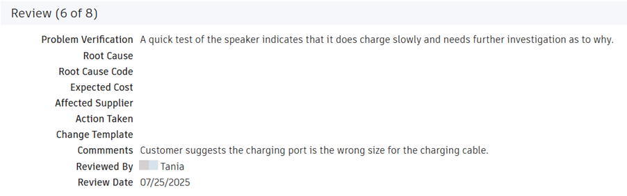

    2. In the Review section, enter values for optional fields.
      • Problem Verification: A quick test of the speaker indicates that it does charge slowly and needs further investigation as to why.
      • Comments: Customer suggests the charging port is the wrong size for the charging cable.
        review info

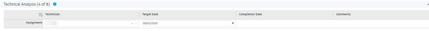

  2. Let's assume further technical analysis is required. Assign yourself as the Technician then submit the PR for technical analysis.
    1. Click Edit.
    2. In the Technical Analysis section, click the Technician field and enter your name.
    3. Set the Target Date to be one week from now.
      assign technician target date
    4. Click Save.

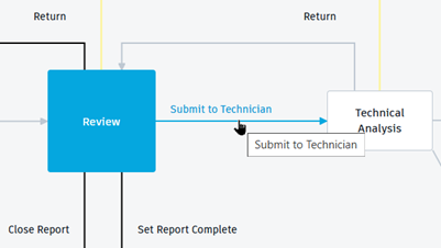

    5. From the Workflow tab, click the Submit to Technician transition. Alternatively. chose this option from the Workflow Actions drop-down.
      submit to technician
      enter comment submit to technician

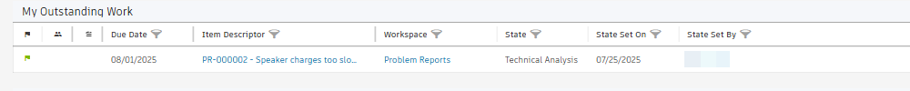

      The assigned technician is responsible for performing an analysis to assess the root cause and potential impact on product design. The technician is notified by email and will find the report in their My Outstanding Work list.
      technical analysis My Outstanding Work

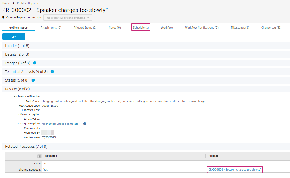

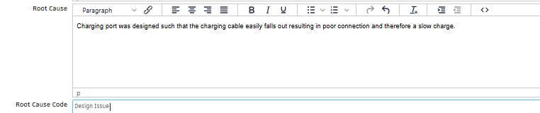

  3. Fill in the remaining information in the Review section.
    1. Click Edit.
    2. Fill in fields:
      • Root Cause - Charging port was designed such that the charging cable easily falls out resulting in poor connection and therefore a slow charge. New design required.
      • Root Cause Code – Design Issue.
      • Fill in any other fields as you see fit.
        enter root cause and root cause code
    3. Click Save.

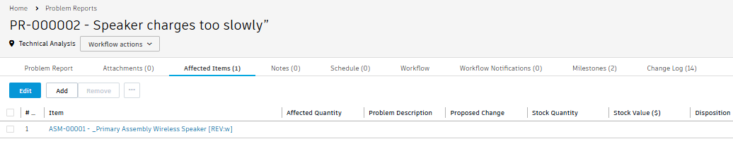

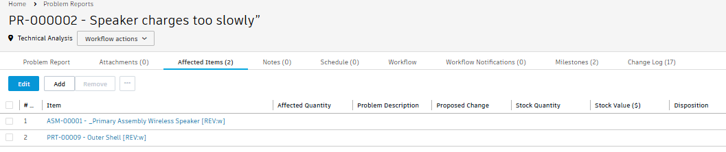

  4. Since changes are required for specific items, these items may be attached to the Affected Items tab of the problem report.
    1. Open the Affected Items tab
      view copied affected item

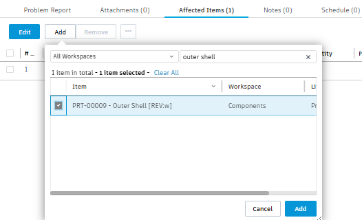

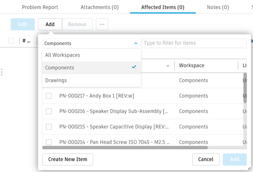

    2. Click Add, then select the Components workspace and search for the Outer Shell component released to production as part of the Wireless Speaker.
      add outer shell affected item
      search outer shell and click add
      Note: You can search for the Outer Shell component without setting the workspace filter.
    3. Select it and click Add. Notice the Outer Shell component has been added to the list of affected items.
      outer shell added to affected items
      Note: In the case of a subsequent change request, this list of items is copied to the change request.
  5. Since it has been determined that a design change is required, you must select a change template before you can use the workflow to create a change request.
    1. Click Edit.
    2. In the Review section, click the Change Template drop-down to select an appropriate change template.
      A change template contains stakeholders and common tasks that would be involved in most change processes. They are used to save time when filling out change requests and change orders that all follow the same process. If one does not exist, you might be able to create one if you have the correct permissions. Click the Quick Create create change template icon to create one. See Tutorial 4: Change templates for steps on how to create a change template that is used for these tutorial examples.

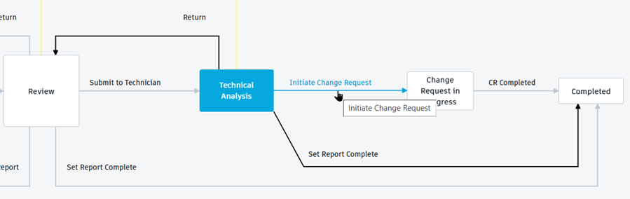

    3. Generate a change request.
      • Option 1: From the Workflow tab, click the Initiate Change Request transition.
        initiate change request workflow transition

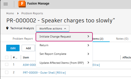

      • Option 2: From the Workflow Actions drop-down, select Initiate Change Request.
        initiate change request workflow action
        enter comment change request creation confirm
A change request is created and added to the Change Requests workspace. A link to this change request is added to the Related Processes section on the problem report as well as the Schedule tab. At this point, the problem report remains in the Change Request in progress state until the change request has been completed.
problem report related process section and change request in progress state
