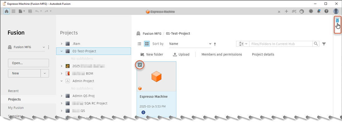

    browser
  • Or, in Home, under Recent or Projects, select a design and click Properties properties icon at the top right of the window.
    home
