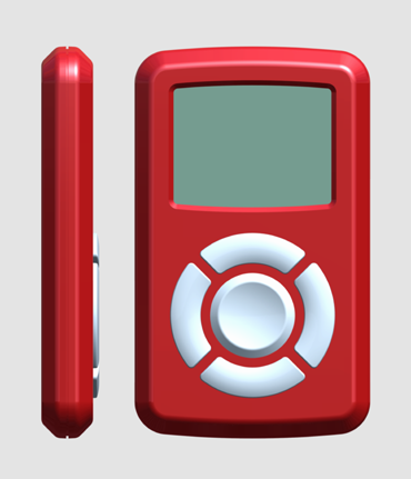

The joystick and vacuum cleaner tutorials focused on building complex forms using freeform shapes. In this lesson, you build an accurate model of an MP3 player. You focus on geometric shapes and working to accurate dimensions. You use keypoint curves to create geometrically accurate lines and arcs.
- Category
New Users
- Time Required
60 minutes
- Tutorial File Used
none
Objectives
Learn how to:
- Use Keypoint curves to create accurate geometric shapes.
- Create surfaces with a draft angle.
- Set up Construction Options for accurate modeling.
- Create edges with a radius using the Fillet and Round tools.
- Create symmetrical and duplicated geometry.
