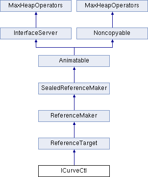

This class is an interface to the curve custom control. An example of this control in the 3ds Max user interface can be seen in the Color Map section of the Output rollup of a 2D Texture map. Sample code using these APIs is available in /MAXSDK/SAMPLES/UTILITIES/CCUTIL/CCUTIL.CPP.
+ Inheritance diagram for ICurveCtl:
