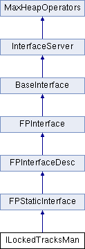

+ Inheritance diagram for ILockedTracksMan:
