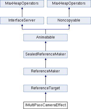

Inheritance diagram for IMultiPassCameraEffect:Public Member Functions | |
