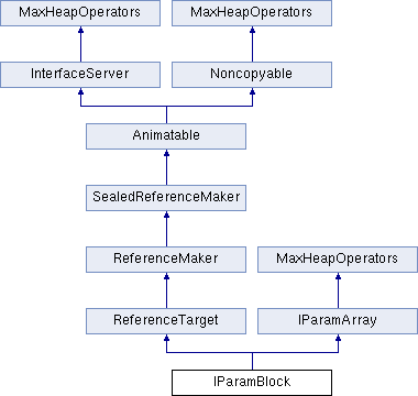

Inheritance diagram for IParamBlock:Public Member Functions | |
